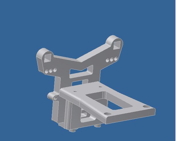

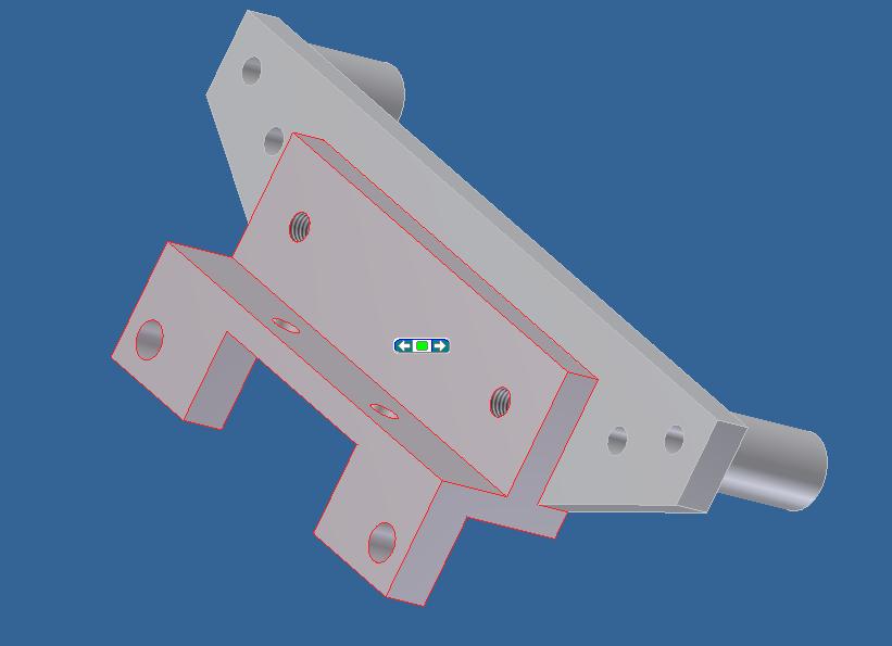

nice to see some of you still have em!
I just bought a used one off craigslist and it was beat to death. Both the front and rear shock towers are cracked where the shocks mount up. Gearcase is cracked bumper is cracked in 1/2.
Too bad there no more replacement parts out there
I made some CAD drawings thats about it haha.

Originally Posted by zabbe View Post
Lots of parts are the same as ta01/ta02. Dont know bout the shock towers, but I'll check...
shock towers are different on the ta02 and ff01
I have a rare shocktower for the TA03 that fits on the ff01 but the camber links dont fit

wait, you need this tower?
I only have the rear but as you see. its allthere what ya got to trade?

thanks for the offer but i already have replacement for the rear. I just wanted to make another replacement out of alum.
