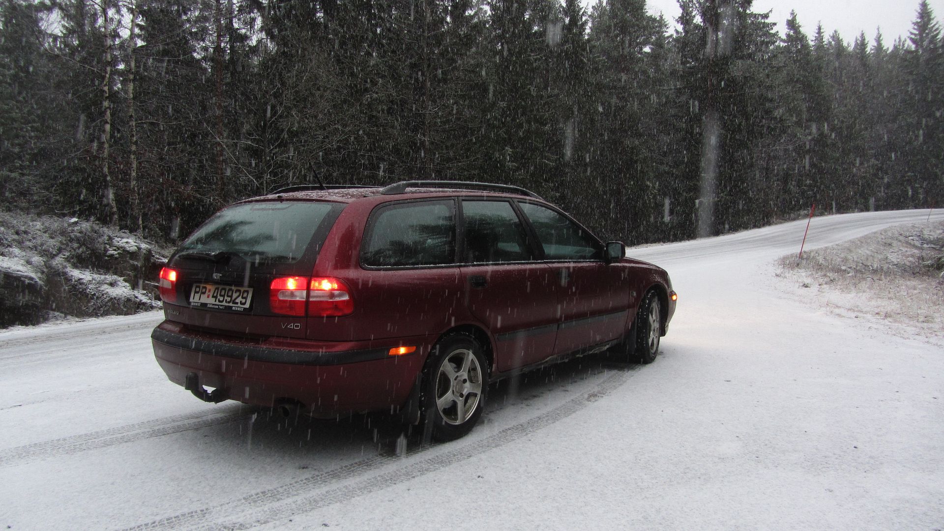

Oh it has been winter here and it works good on snow and ice, even with the cheap winter tires fitted.
Picture from Sunday
